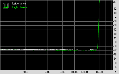

| Frequency response (from 40 Hz to 15 kHz), dB | +0.31, -0.20 |
Good |

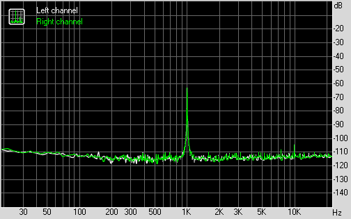

| Noise level, dB (A) | -83.7 |
Good |
| Dynamic range, dB (A) | 83.6 |
Good |

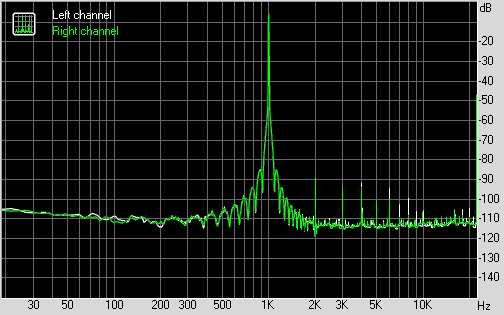

| THD, % | 0.0095 |
Very good |
| THD + Noise, dB (A) | -73.9 |
Average |

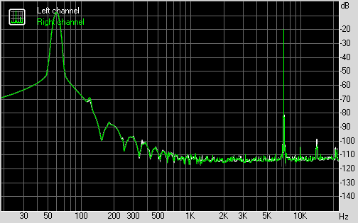

| IMD + Noise, % | 0.045 |
Good |

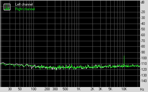

| Stereo crosstalk, dB | -79.9 |
Very good |

| From 20 Hz to 20 kHz, dB | -0.65, +0.31 |
| From 40 Hz to 15 kHz, dB | -0.20, +0.31 |

| Dynamic range, dB | +82.6 |
+82.6 |
| Dynamic range (A-weighted), dB | +83.6 |
+83.6 |

| IMD + Noise, % | +0.0381 |
+0.0522 |
| IMD + Noise (A-weighted), % | +0.0236 |
+0.0224 |

| Crosstalk at 100 Hz, dB | -79 |
-80 |
| Crosstalk at 1000 Hz, dB | -80 |
-78 |
| Crosstalk at 10000 Hz, dB | -78 |
-78 |

| IMD + Noise at 5000 Hz, | 0.0295 |
0.0268 |
| IMD + Noise at 10000 Hz, | 0.0317 |
0.0255 |
| IMD + Noise at 15000 Hz, | 0.0285 |
0.0262 |
